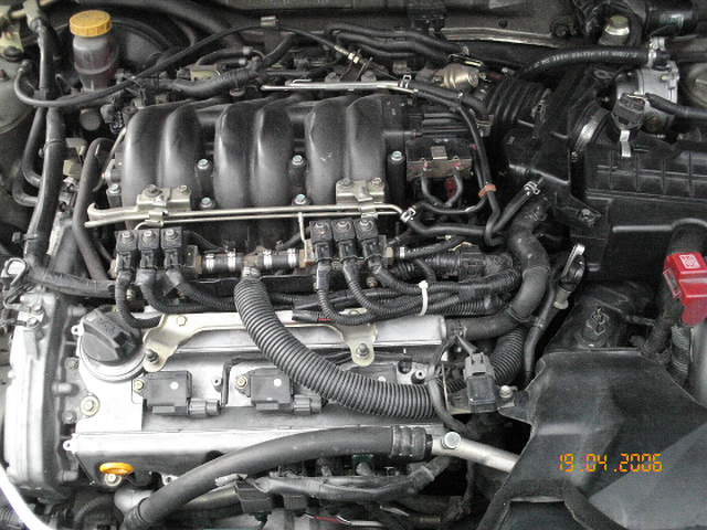

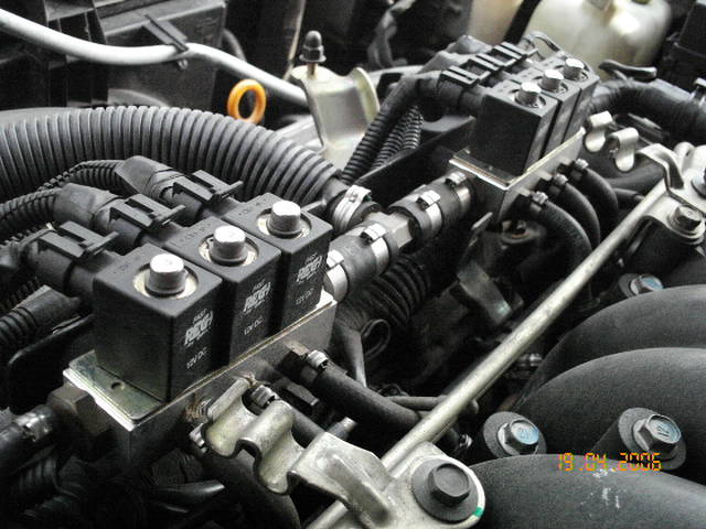

       Nissan Cefiro A33 VQ30DE with LPG coverting kits

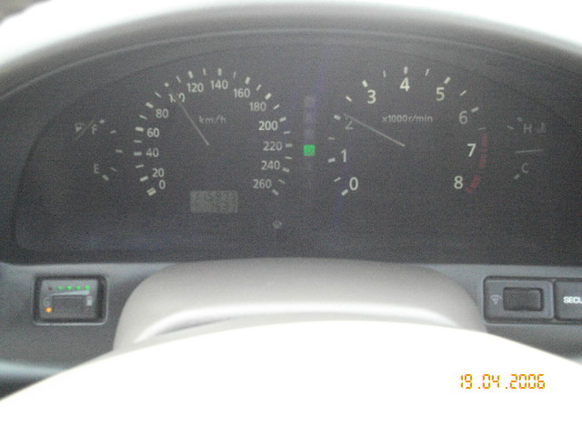

58.9.91.189

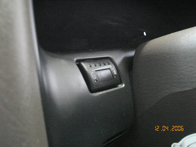

       Driving with LPG mode(see the LPG switch)
 จาก BigBear
 ศุกร์, 12/5/2549
01:15
58.9.91.189
       LPG-gasoline change-over switch

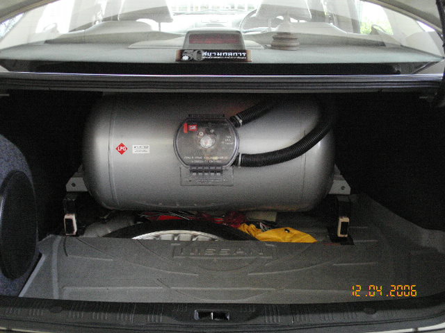

58.9.91.189

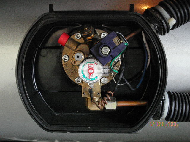

       LPG tank
 จาก BigBear
 ศุกร์, 12/5/2549
01:20
58.9.91.189
       Multivalve

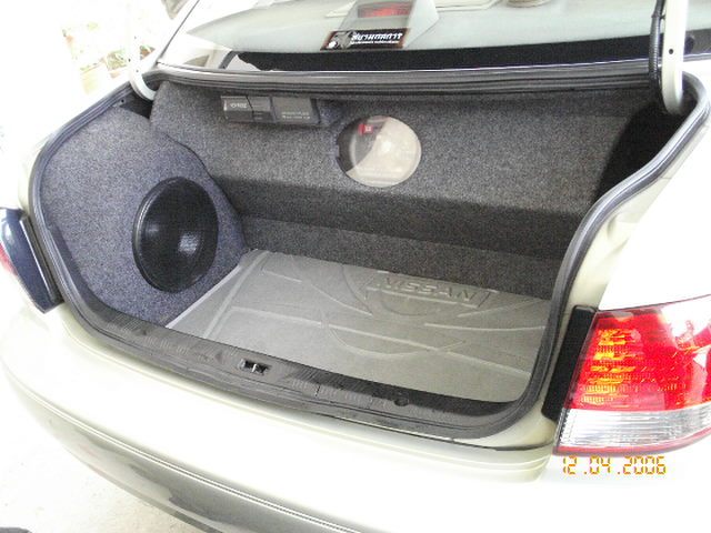

       LPG tank cover from audio shop
 จาก BigBear
 ศุกร์, 12/5/2549
01:22
58.9.91.189
 จาก BigBear
 ศุกร์, 12/5/2549
01:26
58.9.91.189
       Final step...go to suspension shop for adding 1 inch spacer to your rear suspension.
This will fix the lowering trunk from LPG tank load.

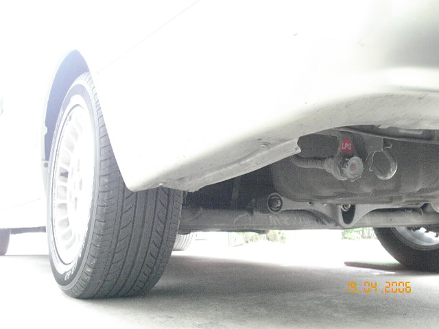

58.9.91.189
       LPG Filling adapter with cap

And for LPG injection system.
If you LPG injection system has some problem with the software part you have to go back to your converting garage. The tuning could be done through LPG control box with computer tuning.
In case of problem arising when you are in up country....Ummmm like you have to use gasoline na krab. Anyway I like to share some comment from real life applications....I drive quite extensive for downtown and up-country with LPG. So far is absolutely OK. The LPG system has shown no failure sign yet. I think the system is quite reliable.
Anyway you will need to get back to the garage for a few times for fine tuning or other problems solving which could happenned case by case.
