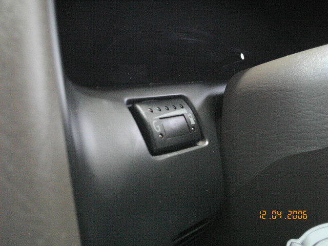

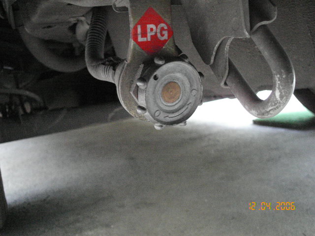

Have a look for further details from this link http://www.cefiro-ff-club.com/webboard/viewforum.php?f=14

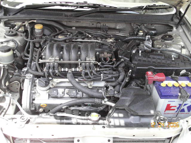

I have converted my A33 to use LPG injection system nearly 40,000 km.
Take your time to learn about each type of LPG converting. Then go for the system that suit you the best krab.

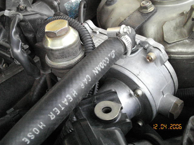

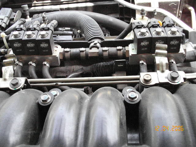

       LPG Injection Rail
 จาก BigBear
 พุธ, 12/4/2549
13:47
58.9.92.93
       LPG injecion rail

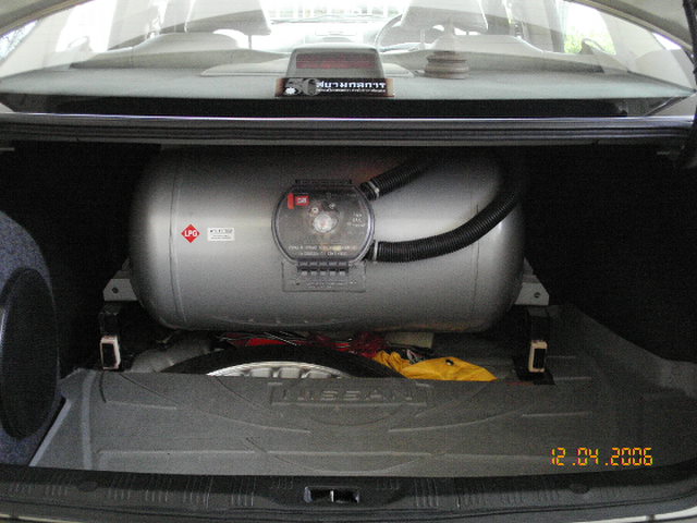

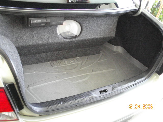

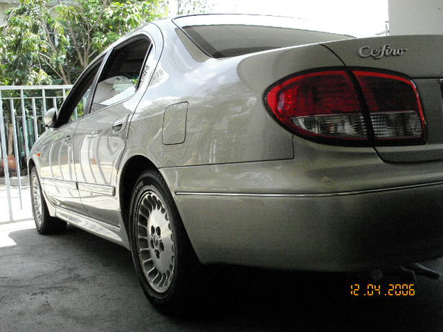

       I went to the audio shop for making this tank cover.
 จาก BigBear
 พุธ, 12/4/2549
14:00
58.9.92.93
       overview from right rear side
 จาก BigBear
 พุธ, 12/4/2549
14:01
58.9.92.93

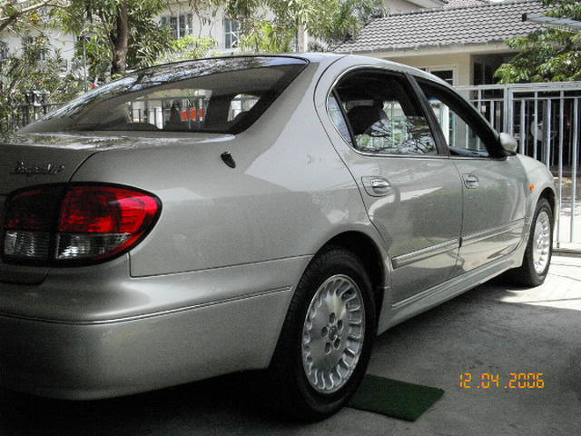

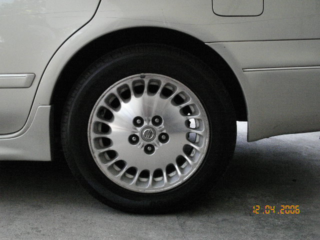

       left rear wheel with 1 inch spacer
 จาก BigBear
 พุธ, 12/4/2549
14:03
58.9.92.93
       overview from rear back left krab
