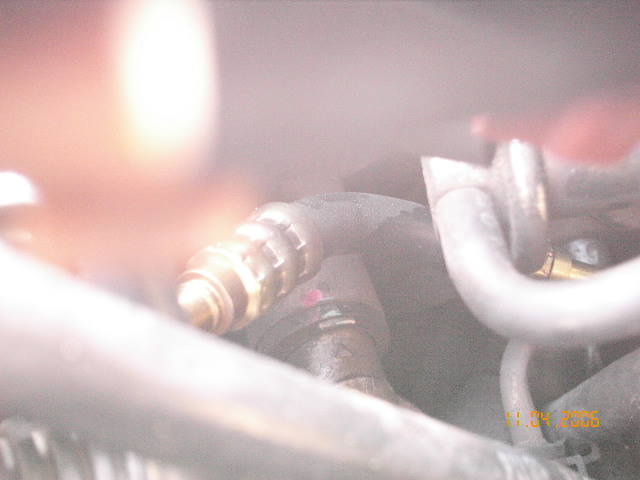

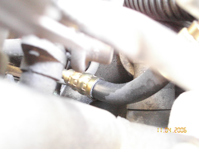

       Nissan Cefiro A33
Just cut-off the fuel pump yesterday krab after converting to use LPG nearly 40,000 km krab.
I found that the inlet fuel hose to for the gasoline injection rail had been leaked. Basically the injection heads for the gasoline are not allowed to operate in LPG mode. But the fuel pump keeps delivering the gasoline to the line all the times.
You will find slightly rough transition during transition from gasoline to LPG mode krab.
I think let check with the guys who converted to LPG and used the same car as you. Your LPG gargare will be a good solution on this issue krab.

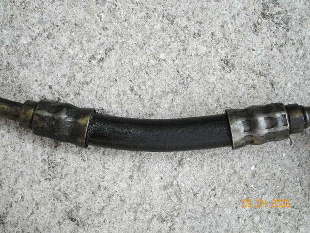

       This is my old inlet fuel hose krab.
Do you know where I could modify the fuel hose for higher in the line. So I could use the old adapters from this old line for modification.

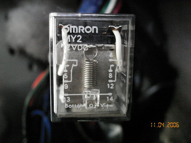

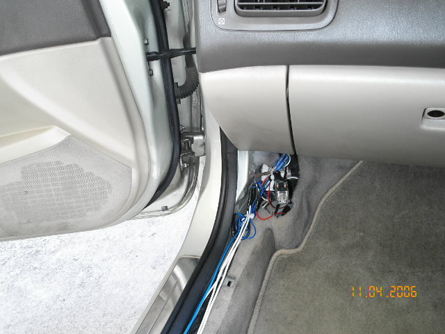

       The fuel pump now will be turned-off when using LPG with relay.

       Zoom in the relay for cut-off the fuel pump.

But....I do really have the problem with fuel hose to the injection rail. I just changed the new fuel hose on 5th April 2006.
Then I saw the sign of leaking again only 11th Apr 2006. Just only about ONE week!!!!
 จาก BigBear
 ศุกร์, 14/4/2549
09:52
58.9.98.203
       The new fuel hose with only 1 week old.
Ummm....start to leak again.
The fuel pump was not cut-off krab.

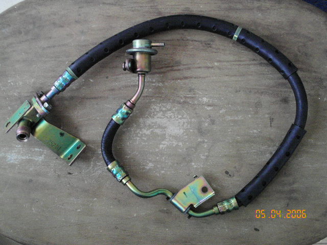

       Leaking fuel hose (cont.)
 จาก BigBear
 ศุกร์, 14/4/2549
09:58
58.9.98.203
       Old Fuel Hose-Leaking area krab.
