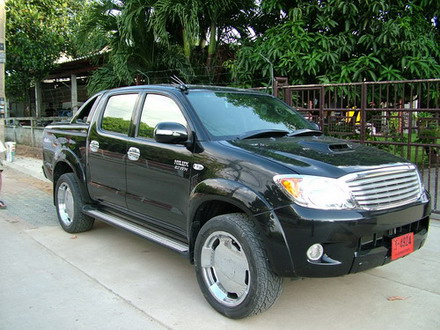

       Below please find sample information for your consideration
VIGO 2.7 VVT-i 4X4
Lambda control(std.) 19500 บาท + Super type tank(Option) 1500 บาท Total 21,000 บาท
Max speed > 160 km/hr. No engine check show.

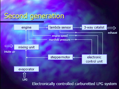

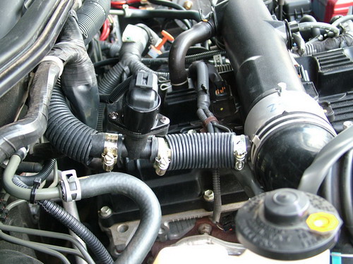

Stepping motor( Lambda control ) & Mixer

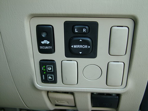

Tamona Auto-change Switch
